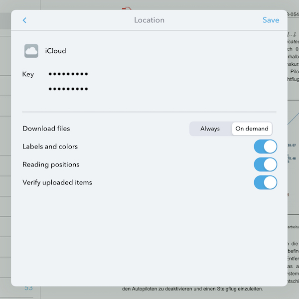

Sync location showing encryption key

When you enable or create a sync location in DEVONthink’s Preferences > Sync or DEVONthink To Go’s Settings > Sync: Locations, there will be two fields to enter an optional encryption key. Enter it in both fields; the second one is to verify the entry. Then you can enable databases to sync in that location, but you must enter the key before syncing.

  • In DEVONthink for Mac: Control-click the sync location in DEVONthink’s Sync preferences and choose Clean Location. After the clean has been successfully reported in Window > Log, Control-click the location again and choose Show Info. You can now add, remove, or modify the encryption key. Then enable databases to sync again.
  • In DEVONthink To Go: Go into the Settings > Sync: Locations, left-swipe the sync location, and choose Clean. A triangle should appear on the sync icon in the bottom toolbar to indicate a log message. Touch the icon and ensure the clean was successful. Then go back into the Sync settings, touch the Edit link at the upper right, and select the sync location. Add, remove, or modify the key and touch Save. You can now touch the sync location and enable databases to sync.
